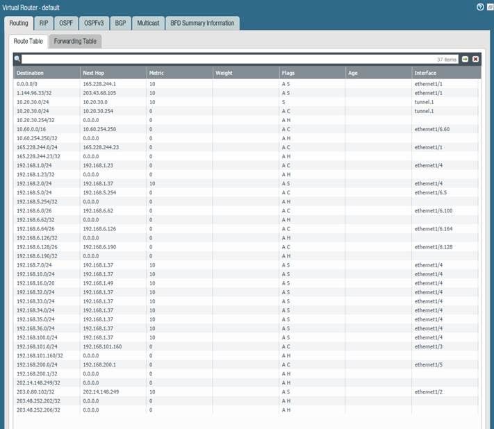

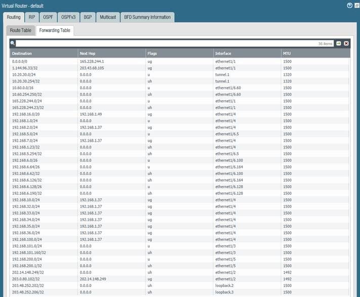

2 PA-500 devices are in active-passive configuration. When connected via global connect, getting IP address in the correct range but cannot reach any internal address and trace route does not proceed beyond the first hop of the gateway on the Firewall.
However, from a PC behind the firewall on the network, we can ping the GlobalProtect PC connected over the internet.

In the traffic log, I can see packets sent=packets received...only season end reason showing aged-out.
Security policy is allowed from LAN (interface tunnel1) to LAN (interface Eth1/4).
GP gateway settings has access route setup.
Configs | User/User group | OS | IP pool |                         Access Route
Default        Any                    Any  10.20.30.0/24             192.168.1.0/24
                                                                                              192.168.2.0/24
                                                                                              192.168.10.0/24
                                                                                              192.168.100.0/24
                                                                                              192.168.101.0/24

Was going to say something similar. Does your internal network have a route for 10.20.30.0/24 for the returning packets?

This is a fine temporary solution.  But this solution is showing you that the previous comments about asymmetrical routing in your network here are correct.
The best permanent solution is to identify how to get the return traffic from these internal hosts to use the same path that the outbound traffic from the vpn hosts are using to reach those hosts.  As noted above this is likely a missing route somewhere.
Or it could be the need to create a routed link into the internal zone instead of connecting multiple routers to the same subnet.
PA firewalls can best protect against threats only when they see the full flow of the traffic both inbound and outbound in a symetrical routing setup.  This is why the default behavior is the block asymmetrical flows to help you see that this path is not optimal and can allow some threats to go undetected.
